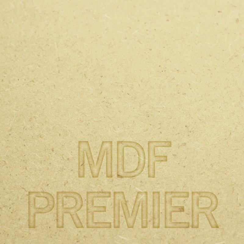

Premier MDF is produced using superior wood refining technology and specially designed resins. Excellent face properties make it suitable for the thinnest laminates and surface coatings. End-users enjoy consistency of quality and thickness, as well as reduced tool wear.
Applications The range of product applications for MDF includes, for example, contemporary furniture, reproduction furniture, childrens’ toys, snooker tables, shop-fitting, hi-fi speaker cabinets and doors.
Performance Premier MDF is suitable for use in internal dry conditions as defined in EN 622 parts 1 and 5 and conforms to EN13986. Boards of this type are suitable for use in Hazard Class 1 of EN 335-3.
Appearance Premier MDF retains the light tan colour of the wood fibre from which it is manufactured.
